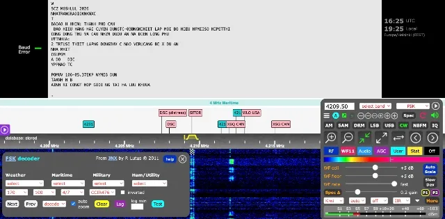

SITOR transmissions still exist worldwide.
The coastal station Nha Trang Radio (Vietnam) operates at 4209.5 kHz with the call sign XVT.
It can be tuned and decoded (FSK 170 Hz - 100 baud - 4/7 bits - CCIR576) using KiwiSDR tredxk.no-ip.org:8073
