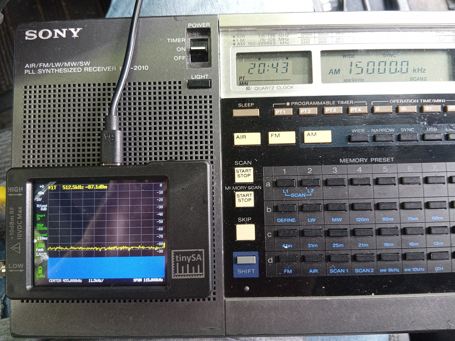

Adding spectrum scope to my Sony 2010

Why this radio has multiple scan buttons?
Coll invention…!

The Sony can scan memories or band segments … you hold the shift button down and select the meters of the band …then hit scan … it will scan the meter band segment … also it will scan between memory 1 and memory 2 as you program those two with your scan area … even scan between two close frequencies …. The Sony was and is very versitile

That’s a rock solid radio. A real radio, one worth tinkering with like this!
If you run FLdigi you on your computer and pump the audio from your radio into Fldigi then you can have a bigger spectrum scope.
